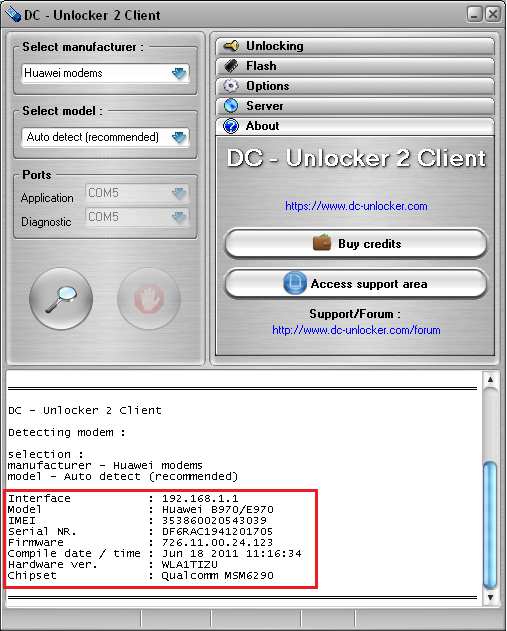

Detect device by selecting Huawei modems from manufacturer's drop down menu list, then click magnifying glass button
If you get "modem not found" error, check this procedure. Also make sure to wait before detection for device to check it's functions (Blinking icons on router's front side)

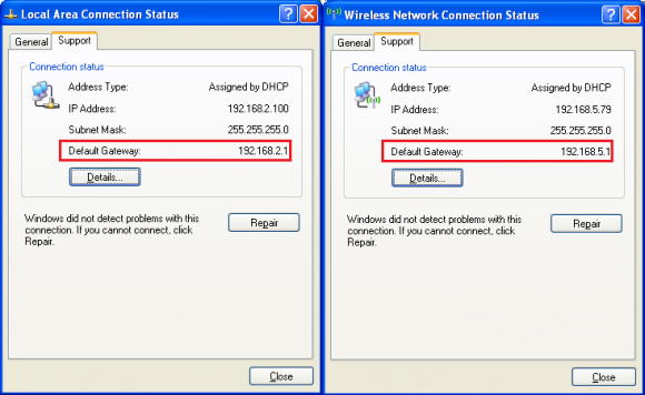

Note: Device can be detected only by certain IP addresses like 192.168.2.1, 192.168.1.1, 192.168.0.1 etc., make sure one that belongs to your router is not occupied

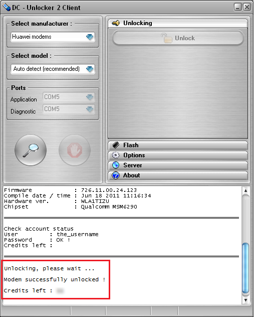

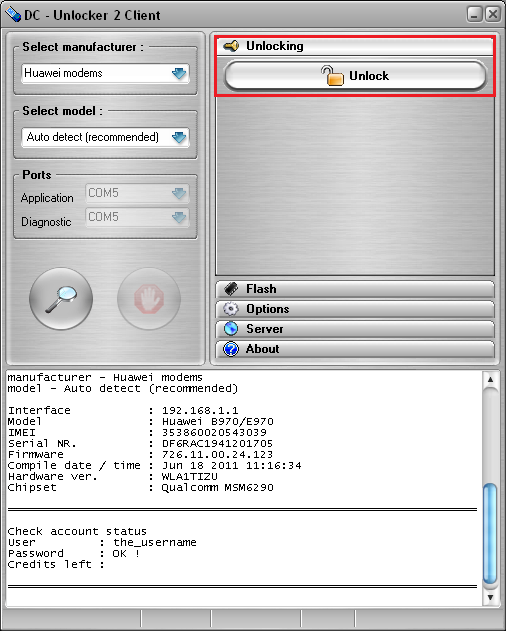

After you seem message that modem was unlocked, restart device. Now you can use it with any other operator's sim card.
